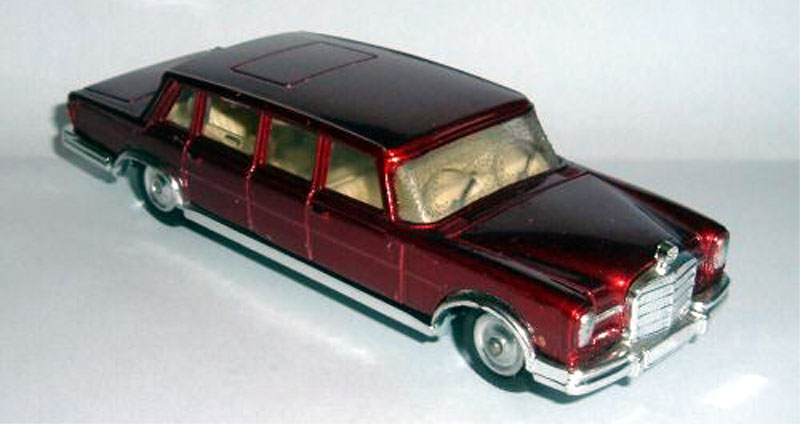

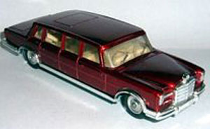

Corgi first issued this model in 1964. The model came with working windscreen wipers, dappled front windscreen (to represent rain) and rear passenger windows that slid up and down. The model remained in the Corgi Toys range until 1969 and appears to have only been issued in a metallic maroon colour with the usual plastic interior and chrome plated parts.

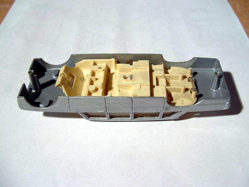

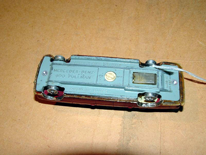

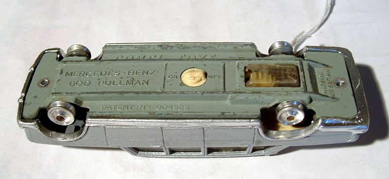

  • Drill out the base-plate rivets to enable removal of components.
Image 1 Corgi 247 base

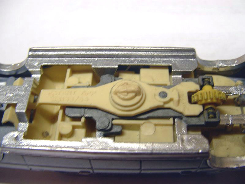

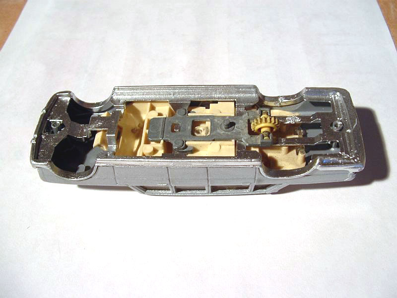

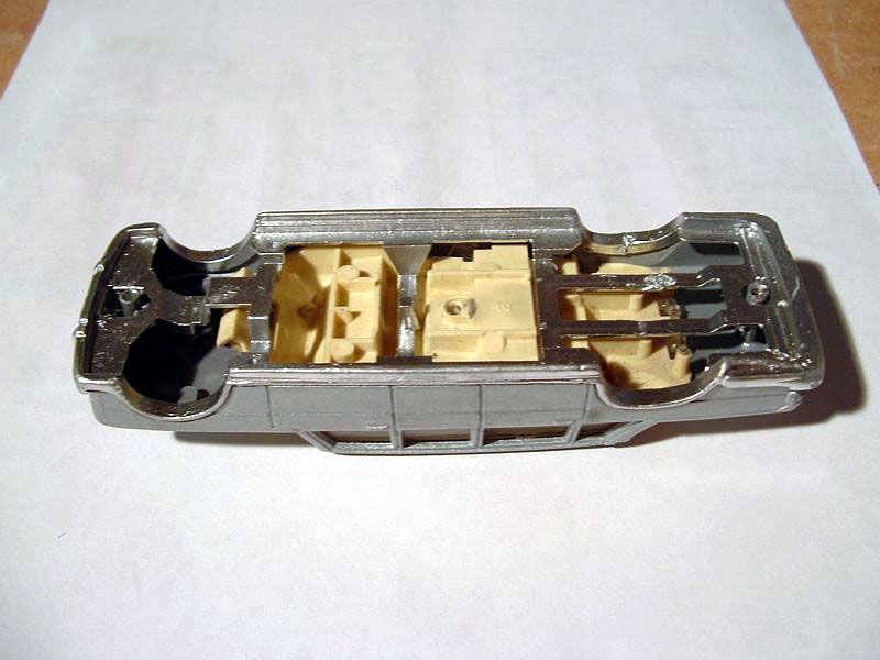

  • Remove the base plate to expose the internal components
Image 2 Corgi 247 base off

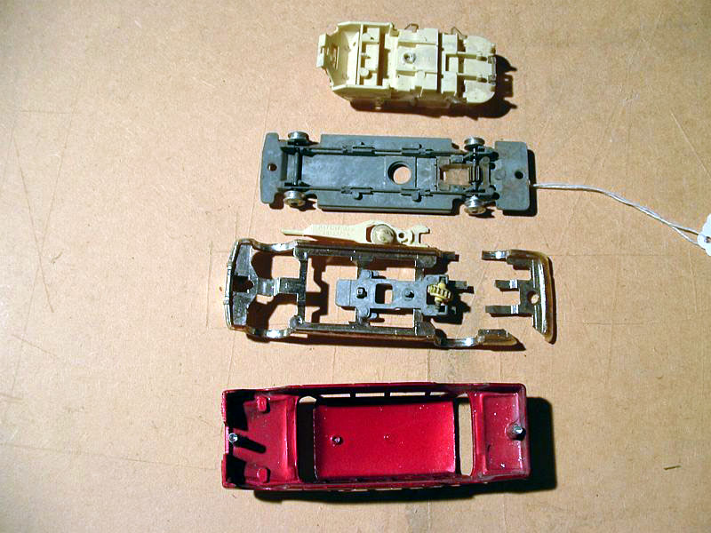

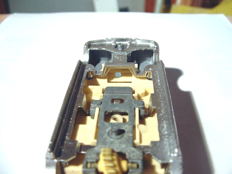

  • Remove the plastic chromed parts (bumpers and side trim) and wiper mechanism.
Image 3 Corgi247 Bumper components

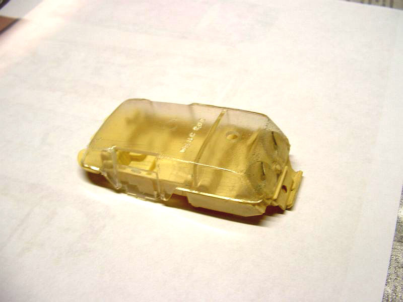

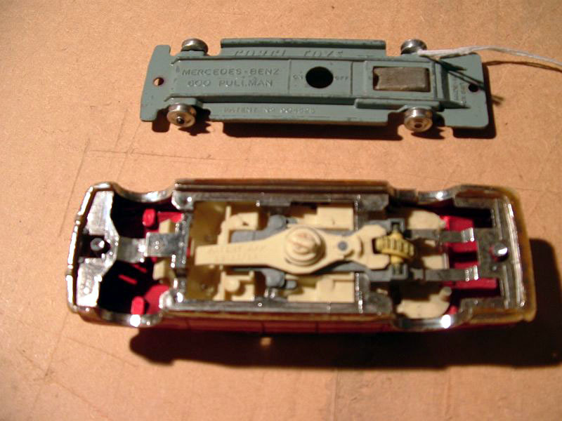

  • Remove the interior and windscreens to facilitate cleaning of the parts and buffing of the screens (if required).
Image 4 Corgi 247 all components out

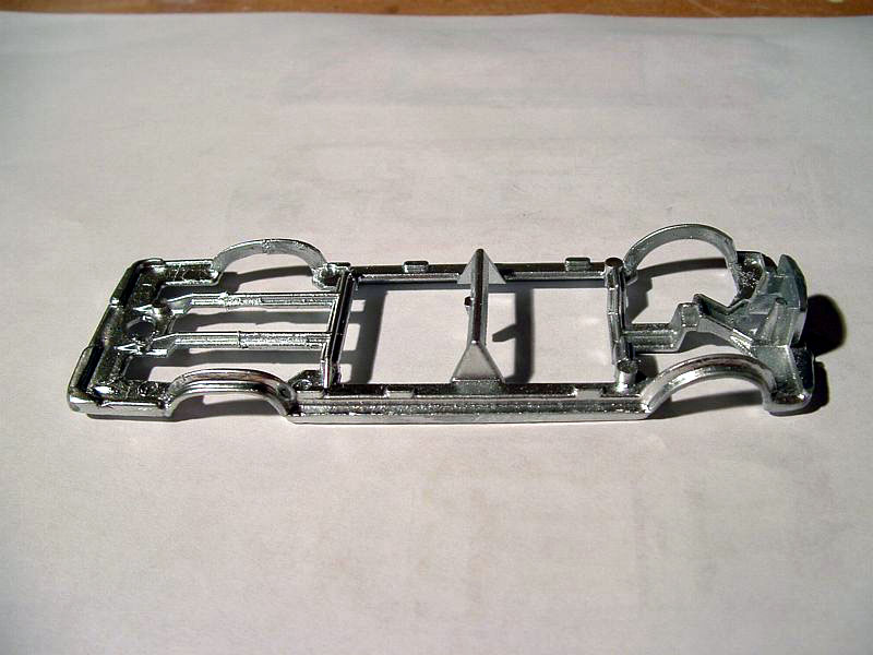

  • Strip, re-glue and repair the components, then re-spray the parts with primer/undercoat (grey) and chrome – I used a can of Chrome Automotive Touch-up Paint obtained from the local SuperCheap Auto store.
Image 5 Corgi 247 rebuilt and rechromed bumpers

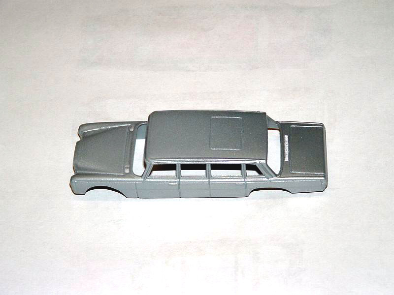

  • Next clean and make any necessary repairs to the body. Re-spray with primer/undercoat, sand where necessary, then re-spray (in this case in metallic silver).
Image 6 Corgi 247 undercoated and resprayed silver

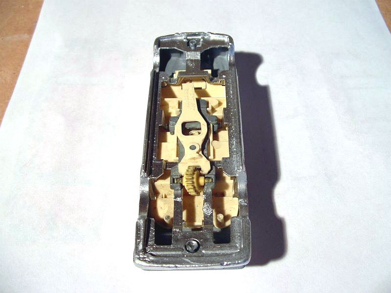

  • Now fit the wiper driving mechanism ensuring it is up the right way.
Image 10 Corgi 247 wiper driver mechanism refitted

  • Carefully fit the plastic pin into this hole and fit the component into place.
Image 12 Corgi 247 full mechanism in place
  • Then insert the metal driving cam into its central position.
Image 13 Corgi 247 mechanism closeup

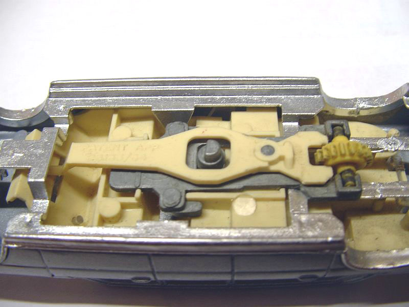

  • Carefully place the plastic switch over the cam.
Image 14 Corgi 247 mechanism closeup 2

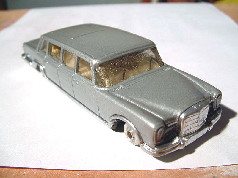

  • Since I have not fixed the base plate you’ll have to do with this "finished" shot! Reproduction tyres still to go on.
Image 16 Corgi 247 Almost finished model
